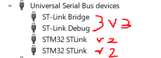

Andrew Neil
Do the ST-Links appear in Device Manager?
Yes:
and I'll mention again that CubeProgrammer is able to communicate successfully with the target through all three ST-Links.
