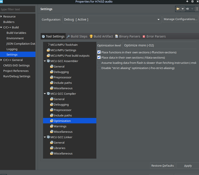

AScha.3
there is no difference between debug and release, just two (preset) settings .
The arm core always has its debug unit working and there is no difference in code - using debug or not.
What IS different : the settings (you can set/change) for optimizer and download/flash :
- optimized code might not jump from line to line , as debug is expected to do
- flash and then : just run or start debug session  is also just a setting
I use always -O2 , best compromise between speed and code size, so i recommend this.
And just set it in C settings... ->

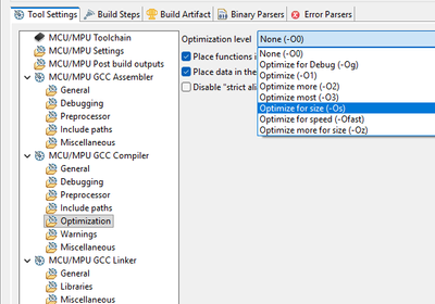

Using -O2 debugging might more diffult since the machine code differs from source code more or less.
So -Og is a good choice for debug builds where optimations are not as aggressive with debugging in mind.

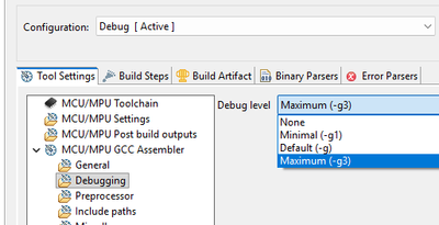

as extra optimization levels pointed previously
takes care to debug level which may help you experience too

@Ricko wrote:
When I compile in Debug mode, the firmware uses about 79% of the available flash. Switching to Release mode reduces this to around 45%, which is a big improvement.
As the others have said, this will be due to a different optimisation setting between your Debug and Release configurations.
The GCC optimisation settings are documented here:
https://gcc.gnu.org/onlinedocs/gcc/Optimize-Options.html
In particular:
 -Og should be the optimization level of choice for the standard edit-compile-debug cycle, offering a reasonable blend of optimization, fast compilation and debugging experience.
https://gcc.gnu.org/onlinedocs/gcc/Optimize-Options.html#index-Og
As others have said, the higher the level of optimisation, the harder it is to follow in the debugger.
