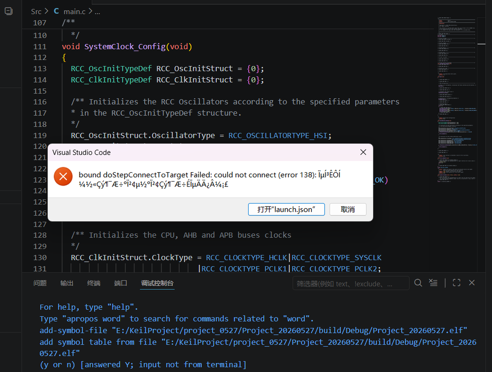

ST-Link can't connect in VSCode using ST-Link GDB server; but OK in Keil

LaurentL
In the debug console text, can you check that the STLINK Firmware is not outdated and needs to be upgraded.
Or check if you see any error message.
Rgds,
Laurent
Andrew Neil
Welcome to the forum
Please see How to write your question to maximize your chances to find a solution for best results.
In particular:
  • What STM32 device are you using?
  • What board?
  • What ST-Link?
Note that both a clone STM32 and a clone ST-Link could cause this type of thing - see:
Blue pill (STM32F1) programs OK via Arduino IDE but not Keil. Chip ID:0x2BA01477
How to recognize a genuine ST-LINK/V2 versus a cloned one
