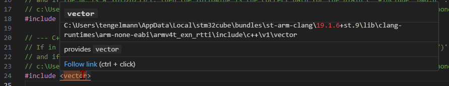

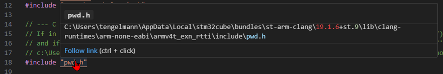

The clangd is NOT using the correct paths for the system includes.
I use here the NUCLEO-H753ZI board with STARM_NEWLIB setting. The following paths should be the right:
But if I hover the mouse over the plain C #include “pwd.h”, I see this path:
C:\Users\[user]\AppData\Local\stm32cube\bundles\st-arm-clang\19.1.6+st.9\lib\clang-runtimes\arm-none-eabi\armv4t_exn_rtti\include\pwd.h
Similarly, the path is incorrect when I hovering over the C++ #include <vector>:
C:\Users\[user]\AppData\Local\stm32cube\bundles\st-arm-clang\19.1.6+st.9\lib\clang-runtimes\arm-none-eabi\armv4t_exn_rtti\include\c++\v1\vector
To be absolutely sure that this is NOT the correct path, I can open these headers by clicking the blue Follow link and insert an #error “Test” at the beginning of the file. After this I perform a >CMake: Clean Rebuild , but the build is still error-free. This means: this file is not used for the build but clangd is using this. If I insert now the same #error line into the vector header file in the correct path, the build aborts as expected.

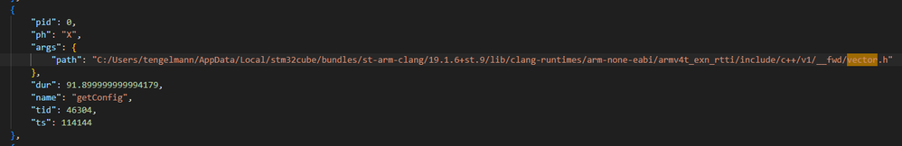

If I add --log=verbose and "stm32cube-ide-clangd.trace”: “clangd_trace.json” to settings.json, it is possible to check what information clangd gets.
If I search for "vector" string I get lines with the correct path (in a "message" node):
but also with the wrong path:

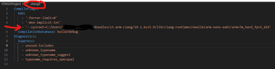

2025-08-28 2:41 PM
@FluxPower42, thanks for confirming that the first fix is okay with you.
The second issue has been reproduced and confirmed.
For now, I’m able to solve the issue by hacking the .clangd file.
This may help in the short term while we work on a more solid fix. Please confirm.

The problem still persists. Is there an update on the status?
I've now implemented a workaround using a script that patches the .clangd file(s).
If anyone needs this script, check out my demo project:
https://github.com/TimoEngelmann/nucleo-h753zi-threadx-demo
The “patch_clangd.py” script runs during CMake reconfiguration and when rebuilding and adds the following to the .clangd file(s):
CompileFlags:
Add:
- '--target=arm-none-eabi'
- '-stdlib=libc++'
- '-isystem'
D:\dev\Tools\ST\STM32CubeRepo\bundles\st-arm-clang\21.1.1+st.7\lib\clang\21\include
- '-isystem'
D:\dev\Tools\ST\STM32CubeRepo\bundles\st-arm-clang\21.1.1+st.7\lib\clang-runtimes\newlib\arm-none-eabi\include\c++\v1
Remove:
- '--sysroot'
- '--config=newlib.cfg'
