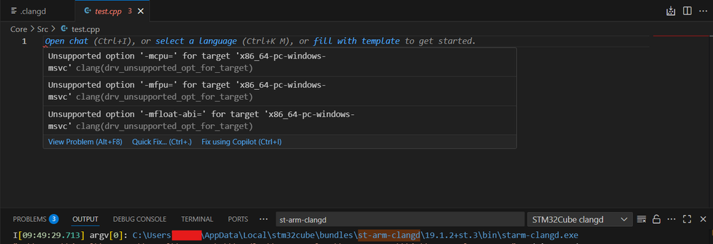

I have set up a project for the STM32H523RET6 using the following setup:
CubeMX: 6.15.0
STM32 vscode extension: 3.5.1
The project is configured to use starm-clang and starm-clang++ and the STARM_PICOLIBC toolchain
I have created a .cpp file () that i added to my build and updated my CMakeLists.txt with the following:
# Setup compiler settings
set(CMAKE_CXX_STANDARD 23)
set(CMAKE_CXX_STANDARD_REQUIRED ON)
set(CMAKE_CXX_EXTENSIONS ON)
enable_language(C CXX ASM)
# Add sources to executable
target_sources(${CMAKE_PROJECT_NAME} PRIVATE
    Core/Src/myclass.cpp
    # Add user sources here
When building the project, it compiles fine, but clangd reports the following problem:
nsupported option '-mcpu=' for target 'x86_64-pc-windows-msvc'clang(drv_unsupported_opt_for_target)
Unsupported option '-mfpu=' for target 'x86_64-pc-windows-msvc'clang(drv_unsupported_opt_for_target)
Unsupported option '-mfloat-abi=' for target 'x86_64-pc-windows-msvc'clang(drv_unsupported_opt_for_target)
Is this a known issue?
For reference (or anyone having a similar issue) i managed to temporarily fix the issue by explicitly setting the target for clangd by changing the .clangd file from

jostlowe
Thanks for the quick response :)
Checking that it point to the correct compilation database in the way you suggest i get the following:
I[14:07:40.019] Loaded compilation database from c:\my\path\project_folder\build\Debug\compile_commands.json
Ok ... and what if looking for 'clangd.exe' as part of filter of the very same output channel ?
Are you getting in real something like '<local path>\st-arm-clangd\19.1.2+st.3\bin\st-arm-clangd.exe' ?
Asking because you have to rely on ARM embedded LLVM utilities not PC ones.
jostlowe
 C:\Users\<username>\AppData\Local\stm32cube\bundles\st-arm-clangd\19.1.2+st.3\bin\starm-clangd.exe
Did what you suggested: Seems to be using the right utilities?
Yes it is. So ?
jostlowe
Still seeing the same errors.
Its no biggie, as i got it to work with the fix in the .clangd file, but I thought it might be interesting for the devs of the STM32 VScode extension to have a look at
