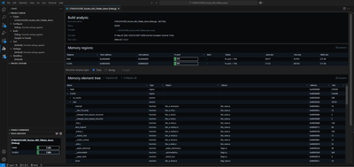

Would like to be able to use Build Analyzer.
Hollies
I hope to use the same Build Analyzer in VSCode as in the IDE, which allows developers to more clearly see the use of flash and memory. I have tried to use GPT to write a plugin, but the effect is not good, and I don't understand the JS language well, so it is difficult to develop it by myself.

Looks very nice!
Is this an add-in to VS Code?
Just a small suggestion: memory sub areas could perhaps be indended under the parent area?
Yes, here is a link to the VSCode Marketplace
Feel free to write whatever you think about it. I have no idea how to make plugins, it all happened by accident. I was just very disappointed when I started taking my first steps in VSCode for STM32 and didn't find such a useful tool. The layout is far from perfect, but at least it responds to clicks, expands and collapses)) It's a big success for me. Indents are important, 100% agree

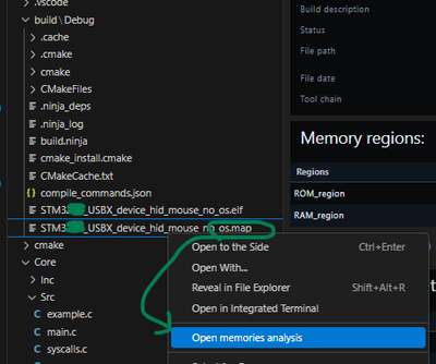

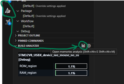

  1. how to run this , i have lloaded .map file ,
  2. what is the next step?
There are some different ways to open it:
From Explorer view:
From CMake Tools view:
If you do not yet have a successfully compiled project resulting in an elf/map-file combo, the build analyzer cannot show any info.
