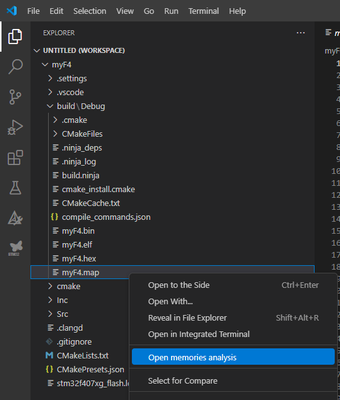

hi i am using build alayzer but nothing shows as when i loaded map file and selected show memory analysis.
what are the steps to be done ?
please see the pictures i have done.
  1. loaded .map file
  2. clicked open memory analysis.
  3. nothing happens

Please have a try Thanks File explorer. Right click on your map file to get context menu, some 'Open memories analysis' action should be available. Is this working ?
