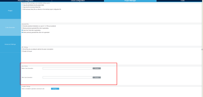

In STM32CubeMX and STM32CubeIDE, you will find fields labeled:
"User action, Before code generation"
"User action, After code generation"
These fields allow you to specify commands or scripts that will be executed:
Before code generation:
The command in the "Before code generation" field runs just before the code is generated from the .ioc file.
After code generation:
The command in the "After code generation" field runs immediately after the code is generated.

Glorious!
Exactly what I was looking for. Had missed the tabs in that view.
Many thanks! :)
