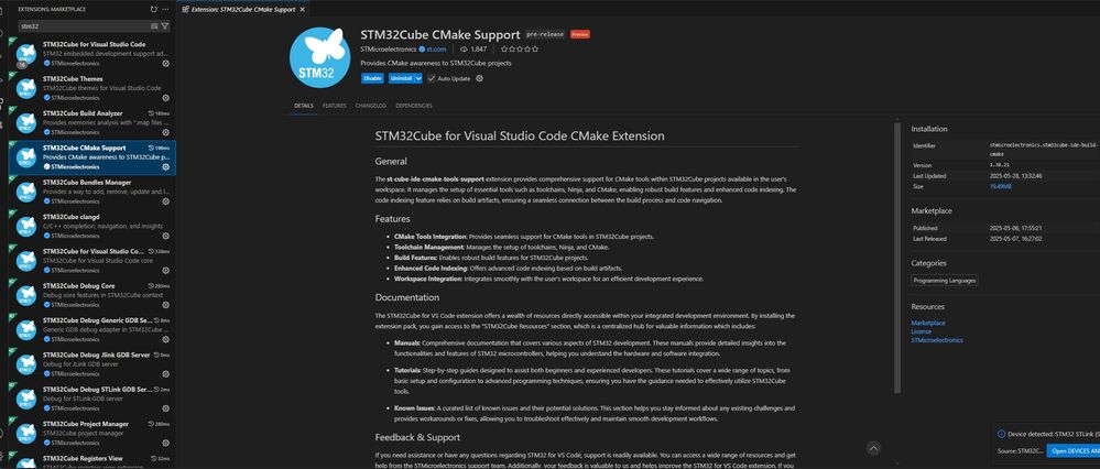

Have you got a chance to try brand new released solution (pre-released takes care you have to push right button to install it) ?
No more "Import" to be done ... just add STM32CubeMX generated projet to your VSCode workspace and at a time just answer "yes" to this notification kind which is happening following Cmake project discovery by CMake tools extension
Sounds @AlanCui4080 has got some good first experience with see https://community.st.com/t5/stm32cube-for-visual-studio-code/why-this-extension-do-not-use-environment-variables/td-p/800975

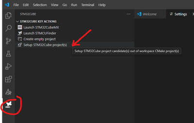

Hi , I installed the new release and works fine , except I do not get the message
"Would you like to configure discovered CMake projects as ST32MCube" projects?
I have STM32Cube for Visual Studio Code v 3.4.11 and is set on pre-release version
Can you help ?

Sounds notification text updated but you have to accept here. This is allowing to convert a CMake project to a STM32Cube project. Extensions are adding couple of metadata live.
‎2025-05-28 11:36 AM
and if you do not get this notification or if you may miss it at a point you can call process back Thanks:

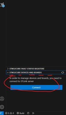

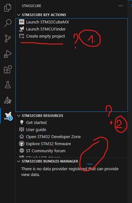

So if I create a project on D:\ drive I get bellow issues in VS Code:
1. I do not have the option "SetupSTM32Cube projects
2. Stm32Cube Bundles Manager seem to search something but never finds ( blue bar slides continuously ... )
Also in STM32Cube Deveices and Boards there's also a continuously search for hardware   
So it seems the issue is related to project path ...
Thanks

Hi, I would still like to have my projects ( workspace ) on the location I use for all projects I am working ...
Could you please help why in other locations these VS Code projects are not working - as explained in previous message...
Thanks,

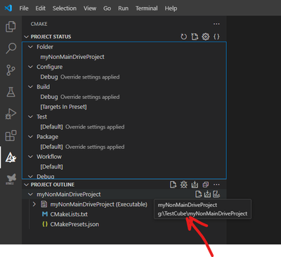

‎2025-06-02 5:31 AM
Works like a charm based on G:\ disk on my side while VSCode install is on my primary drive C:\
Windows 11
