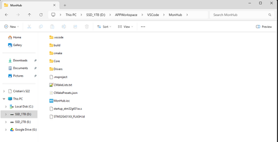

Below the path to a project on D drive:
D:\APPWorkspace\VSCode\MonHub\

‎2025-06-06 11:27 PM
Hi Julien,
All STM32Cube extensions are activated - they are 13 stm32cube extensions + CMake Tools and "Web and Desktop Serial Monitor.
Please see attached picture - should one interfere and may need uninstall ?
I spent some time trying different things but, still nothing changed ...
‎2025-06-13 12:29 AM
Hi @CSand,
I confirm that there are troubles with additional drives usage, especially when vscode is installed from the zip archive, installers work usually better.
Issue is under analysis, we will keep you informed here.
