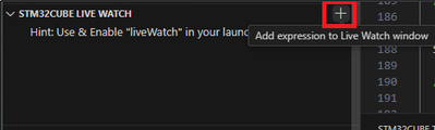

like keil "periodic window updata",now i can see the data by pausing

Hi ApeMan,
You can use the live watch feature in the STM32Cube for Visual Studio Code pre-release 3.5.1 by adding the following attribute in your debug configuration:
"liveWatch": {
    "enabled": true,
    "samplesPerSecond": "4"
An STM32Cube Live Watch view is available in the debug activity bar. You can add an expression using the "+" button.
And then add your expression thanks to this field:
Regards,
/Flo
