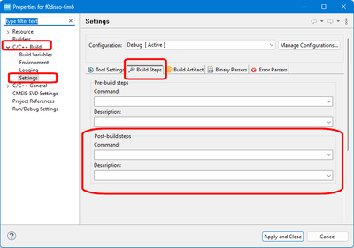

Andrew Neil
Add the conversion as a post-build step;
https://stackoverflow.com/questions/19458031/how-to-create-a-executable-hex-from-elf-file-format
EDIT: sorry, that's for CubeIDE - I guess VSCode has something similar?

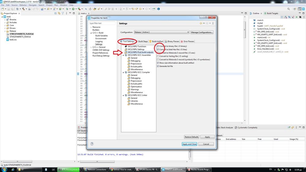

I had the same question and I ended up with this path, which I share with you:

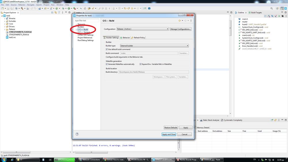

From CubeIDE screen with a project OPEN
I select: Project > Properties and then C/C++ Build.
From the drop down of the C/C++build I select <Settings> and then, on the tab <Tool Settings> I select <MCU/MPU post build outputs>.
I check the boxes Convert to binary and Convert to hex
Finish by pressing APPLY AND CLOSE

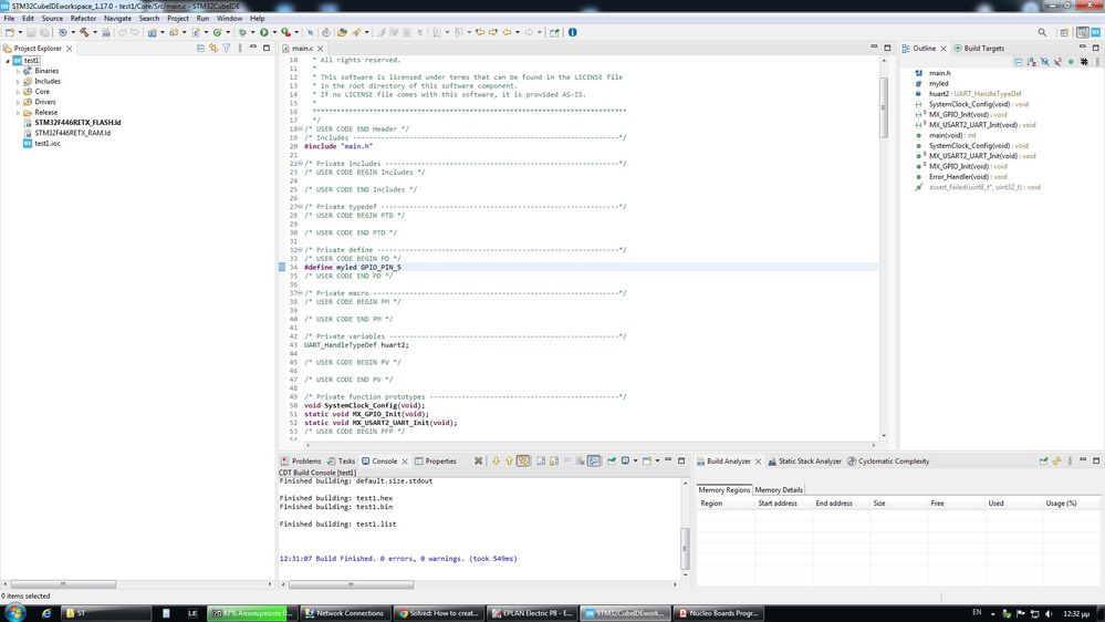

On the next BUILD, the .hex and .bin files are present inside RELEASE folder of the project.
Hope this helped.
