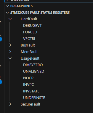

Hi PierreB,
There is a view that shows the type of error occurring:
And I know that the "unaligned access" error is enabled by default in the ST debug configuration.
You can check the attributes starting with "fault", ex: faultUnalignedAccess

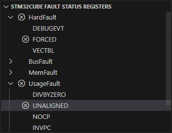

PierreB
Yes, it's an Unaligned fault, and there is no error when I add the argument "-mno-unaligned-access", but I'm not sure exactly what that implies, and I'd rather not modify the default cmake configuration, since it works with the cortex-debug plugin and with CLion (with the same elf file).
This means that executing the code causes an unaligned access without the "-mno-unaligned-access" option during compilation.
However, it is still possible to ignore it without this option if the UNALIGN_TRP register is not set (this is the behavior of Cortex-Debug and CLion).
If the UNALIGN_TRP is set, then execution goes to the error handler.
This is the case with the ST debug configuration, which sets the register by default.

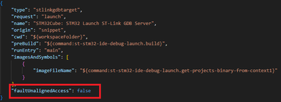

On my side, I simply disable it by setting the attribute to false in my debug configuration.
It's perfect, I checked on CLion and cortex-debug, the “faultDivByZero” is also disabled on this registry.
