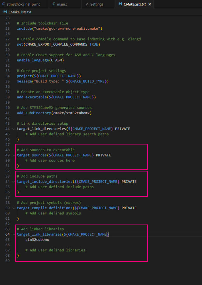

‎2024-10-30 11:37 PM
I finally found one solution :
I added the path to the "CMakeLists.txt" file located in "cmake" folder.
Anyway, if there is a better/more standard way to solve the problem, I'd like to know about it.
Thank you,
Manu
‎2024-10-31 6:23 AM
Hello @Manu_30,
Well done that's it, you need to include and link the external library ssd1351 to your CMakeLists.txt
- Add the include path for the ssd1351 library in target_include_directories
- Add the ssd1351.c source file to target_link_libraries

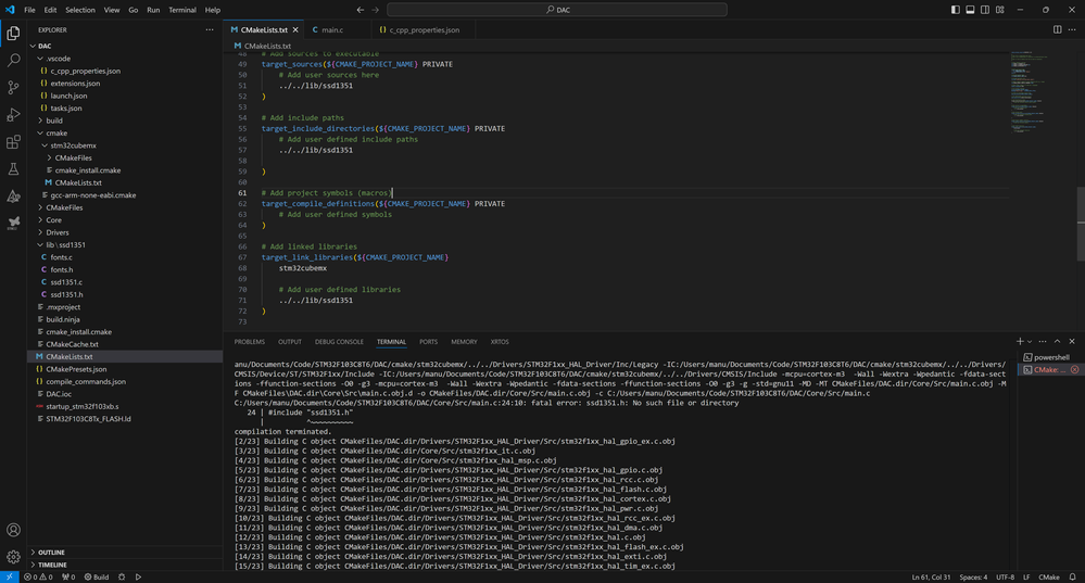

‎2024-10-31 11:13 AM
Thank you Sarra.S.
I don't understand about
The file we speak about is this one :
./project_Name_Directory/cmake/stm32cubemx/CMakeLists.txt
Correct ?
So, in this file I wrote :
target_link_directories(stm32cubemx INTERFACE
../../lib/ssd1351/ssd1351.c
Now I can use
#include ssd1351.h
And the code compile.
BUT, as soon as I use a function from the librairie, I can't compile anymore. I have an error message :
C:/Users/manu/Documents/Code/STM32F103C8T6/First/Core/Src/main.c:101: undefined reference to `SSD1351_Unselect'
while Intellisense find the function.
What did I miss ?
Thank you,
Manu
‎2024-11-01 3:36 AM
in target_include_directories: Add the path to the ssd1351 header files
in target sources, Add the path to the ssd1351 source files
target_link_libraries: links the library to the project
check: cmake-properties(7) — CMake 3.31.0-rc3 Documentation

‎2024-11-02 12:35 PM
I can't make it work :
Plus, I updated SMT32CubeMX to version 6.12.1 and since, STM32F103C8Tx_FLASH.ld is not correct ! It miss the RAM processors and with a straight import in VScode using STM Code extension and using "import Cmake project", the compilation fail. I have to modify the STM32F103C8Tx_FLASH.ld file per hand and add the relevant and missing section :(
‎2024-11-02 1:06 PM
Are you sure "../../" is correct? That's two folders up.
Click "Accept as Solution" if a reply solved your problem. If no solution was posted please answer with your own.
‎2024-11-02 1:16 PM
I'm not sure, but I tried many, many possibilities without success. Even the absolute path don't operate.
Unfortunately there is no documentation about this...
