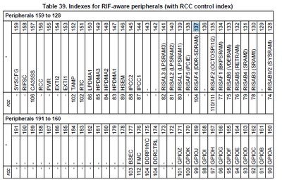

IAC event is related to security illegal access issue (RIF setting related).
according to RM0457, ID 137 is "RISAF4 (DDR-SDRAM)"

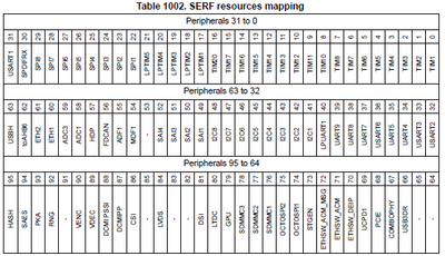

SERC event is related to SW accessing an IP which is not clocked.
according to RM0457, ID 32 is USART2

@PatrickF
Thank you!

@PatrickF
Thank you. Can you post which page you found these IDs?
The only information i have found is from chapter 11.5.5, page 402.

RM0457 Rev5
page 349
page 5760

I don't know why IAC 137 is happening. The SERC was caused by a &usart2 node was pasted in addons in the DT of optee.
If you ok at page 402. The fields I have got are: IANRW = 1, IASEC = 0, IAPRIV = 1, IACID = 1. Which is 0x91.
I using 100% the same RIF konfiguration as the STM32MP257F-DK.
Do you have any suggestions what I need to investigate more?
