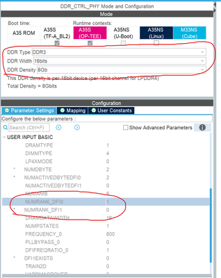

I'm using the mp215 with ddr3l (x16) and an ISSI dram ic that is 8Gb (1 gigabyte) which means it's a dual rank configuration compared to a more typical half gigabyte. As far as im aware all 1GB ddr3 dram ic's are dual rank.
In AN5723 6.1 Note it says "8 Gbit DDR3 defined by JEDEC is uncommon. Practically, DDR3L density is limited to 4 Gbits (max = 1 Gbyte in total). Single rank only is required. ".

However another conflict is in cubemx. I have 16 bit ddr3 set for the DDR_CTRL_PHY config. And i even have Density set to 8Gb implying dual rank. but the greyed out "user input basic" option has NUMRANK_DFI0 set to 1 and it can't be changed. so i don't know how im even supposed to generate a valid dtsi for my case.
Another conflict on top of that is the mp21 control signals DDR_A2 and DDR_A6 pins are CS_N0 and CS_N1. Those are chip select pins ranks. Once again implying it is possible. So which is it? is it supported or not and if it is how do i set it as dual rank in cubemx.

1 REPLY 1
Olivier GALLIEN
Hi @gabriel0
Indeed MP2 does not support Dual Rank. AN5723 is the reference document for such topic.
"- Wiki says it is."
Can you spot where you find this statement ?
Thx
Olivier
