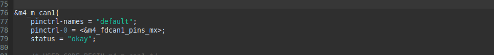

Hi @Artem​ , I have the same issue here, I'm trying to use fdcan in m4, and i upload an new device tree which is generated by stm32cudeide, However nothing to seem to work, even though it's working in engineering mode.
what do you think is the problem?
I notice the clock is not enabled when I'm looking to clock summary
Najib Kassab
this the section for fdcan that is generated by stm32cudeide0693W00000Y9jgBQAR.png
