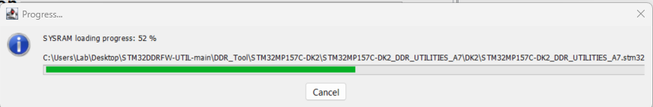

I have similarly tried SYSRAM loading with the UART option selected and with the device in Engineering Mode instead (Boot0 = 0, Boot1 = 0, Boot2 = 1). It appears that the SYSRAM loading is functional at first:
But then the same error is shown once it completes:
Is this the correct way to emulate board bring-up (specifically DDR testing)? Are there any issues with this procedure?

Jan 10, 2025 2:17 PM UTC
Hi @TD_P1
STM32DDRFW-UTIL tag 1.2.1 has been published.
Please use this corrected binary https://github.com/STMicroelectronics/STM32DDRFW-UTIL/blob/main/Binaries/STM32MP157C-DK2_DDR_UTILITIES_A7/STM32MP157C-DK2_DDR_UTILITIES_A7.stm32
Sorry for inconvenience.

TD_P1Author
Jan 10, 2025 3:18 PM UTC
Hello @PatrickF,
The binaries in the new tag did solve my issue (1.2.1), and I can now successfully operate the DDR Test Suite by loading from SYSRAM through the tool.
