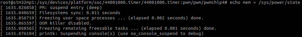

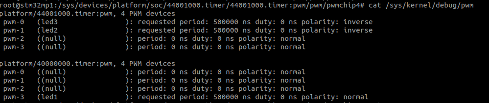

Your DTS looks correct, so I tried to reproduce the problem on my board. I modified the DT configuration of my STM32MP157F-EV1 board to use the same pin than you for pwm2 and pwm8.
If I verify the pins used by doing "cat /sys/kernel/debug/pinctrl/soc:pinctrl@50002000/pinmux-pins", I can see:
pin 125 (PH13): device 44001000.timer:pwm function af3 group PH13
pin 126 (PH14): device 44001000.timer:pwm function af3 group PH14
pin 3 (PA3): device 40000000.timer:pwm function af1 group PA3
So it looks good.
Then if I follow the debug chapter of the wiki page: https://wiki.st.com/stm32mpu/wiki/PWM_overview#How_to_monitor_with_debugfs
_legacyfs_online_stmicro_images_0693W00000dJpI0QAK.pngI can see that led1,2 and 3 are well configured.
But unlike you, I'm able to go in low power mode by calling "echo mem > /sys/power/state". As explained in the wiki: https://wiki.st.com/stm32mpu/wiki/Power_overview#API_description
_legacyfs_online_stmicro_images_0693W00000dJpFPQA0.pngI also tried on a DK2 board and I got the same result.
So right now, I'm not able to reproduce the problem on my side.
Please can you share the complete boot log of your board until you reproduce the problem.
I would like to have all the traces and the commands that you use to try to understand what can causes such an issue?
Even if it is not the same board, I would like also to have the complete DTB.
The goal is not to apply it directly on my board, but to uncompiled it with a tool named "dtc". Then I will be able to see if your configuration is not overwritten by another device tree or another configuration somewhere else.
