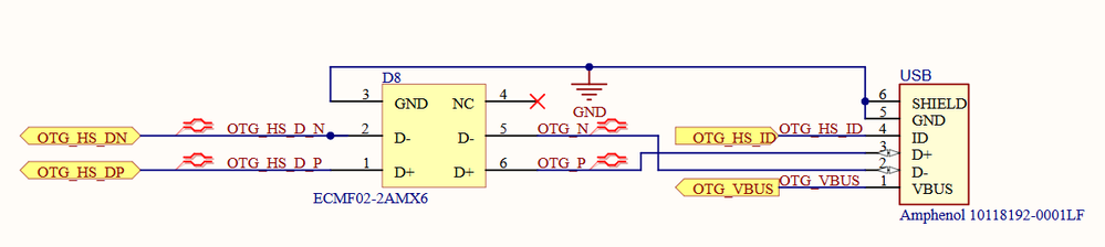

I'm facing the issue were the USB connection is re-connecting, which results that STM32CubeProgrammer re-flashing the device over and over again when the fip-boot has be fully loaded.
So what can cause this restarting and re-connection? Is it something with U-boot?
I have heard that CubeProgrammer may having some issues with timeouts, but in this case, the board is just restarting itself. FAQ : STM32MP1 STM32CubeProgrammer USB reconnect e... - STMicroelectronics Community
Here is the flashlayout:

Here is the last part of the log:

The full log: https://pastebin.com/7JWA3eEG
Here is the schematic of the USB. I'm using USB Micro.
This is the configuration of the USB-OTG for U-boot.
&usbotg_hs{ pinctrl-names = "default", "sleep"; pinctrl-0 = <&usb_otg_hs_pins_mx>; pinctrl-1 = <&usb_otg_hs_sleep_pins_mx>; status = "okay"; /* USER CODE BEGIN usbotg_hs */ /* This board does not have any USB-C connector */ /* USER CODE END usbotg_hs */ };

Here is the solution. Then it boots into U-boot.
alias { serial0 = &uart4; };
