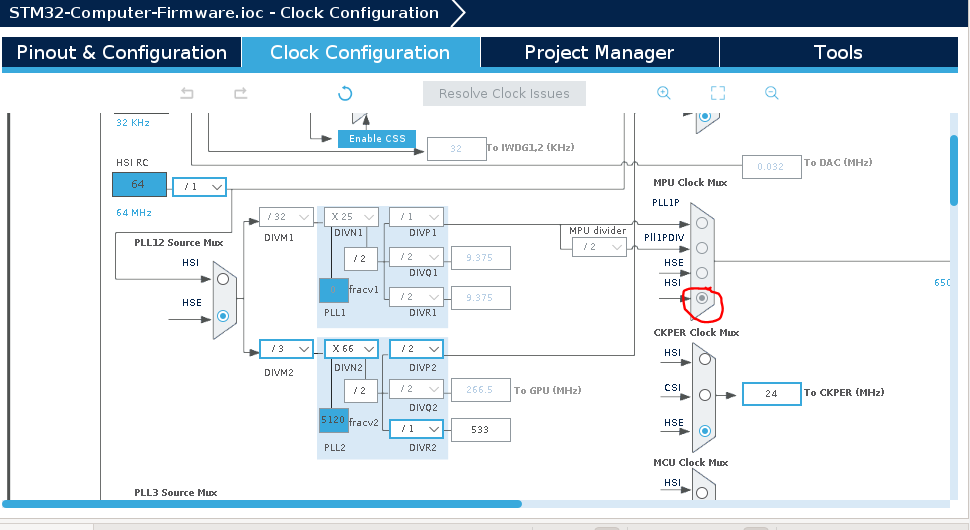

Cannot set the frequency on MPU - set_voltage_then_clock:165 Failed to set clock
‎2024-08-11 11:21 AM - edited ‎2024-08-11 11:42 AM
I think this one might be very easy. It's just a configuration I need to set, but I don't know what configuration I need to write.
We can begin with the error log. The error is about the clock for the MPU. It as not been set yet and I don't know why.
D/TC:0 0 get_opp_freqvolt_from_dt_subnode:1426 Invalid opp-supported-hw 0x2
D/TC:0 0 stm32_cpu_opp_is_supported:558 Not supported opp-supported-hw 0x2
D/TC:0 0 stm32_cpu_opp_get_dt_subnode:623 Found OPP 0 (650000kHz/1200mV) from DT
D/TC:0 0 set_voltage_then_clock:151 opp = 0, cpu_opp.dvfs[opp].volt_mv = 1200
D/TC:0 0 _set_opp_clk_rate:92 opp = 0, cpu_opp.dvfs[opp].freq_khz = 650000
D/TC:0 0 stm32mp1_set_opp_khz:3856 freq_khz = 650000
D/TC:0 0 stm32mp1_set_opp_khz:3873 (mpu_src != RCC_MPCKSELR_PLL) && (mpu_src != RCC_MPCKSELR_PLL_MPUDIV) = 1
D/TC:0 0 stm32mp1_set_opp_khz:3876 TEE ERROR BAD STATE
D/TC:0 0 set_voltage_then_clock:164 cpu_opp.current_opp = 0
E/TC:0 0 set_voltage_then_clock:165 Failed to set clock
E/TC:0 0 probe_driver_node:458 Failed to probe stm32-cpu-opp on node cpu0-opp-table: 0xffff0000
D/TC:0 0 process_probe_list:590 Unresolved dependencies after 5 rounds, 5 deferred
E/TC:0 0 probe_dt_drivers:795 Probe sequence result: 0
D/TC:0 0 print_probe_list:397 Probe list: 0 elements
D/TC:0 0 print_probe_list:403 `- Probe list end
D/TC:0 0 print_probe_list:409 Failed list: 1 elements
E/TC:0 0 print_probe_list:411 |- Driver stm32-cpu-opp on node cpu0-opp-table failed
D/TC:0 0 print_probe_list:414 `- Failed list end
E/TC:0 0 Panic at core/kernel/dt_driver.c:797 <probe_dt_drivers>
The error log showing that it could find the OPP configuration for STM32MP151AAC3 processor. Here is a snippet from STM32MP151.dtsi from Op-tee.

I did put some DMSG messages in the .c code. The error appear at line 56 in this code. It giving me the return TEE_ERROR_BAD STATE. That means that the PLL1 clock is not set for the MPU...I guess.

Question:
How can I configure so PLL1 is the MPU clock source? It seems that my STM32CubeIDE 1.16.0 did not add the clock source so I did it by myself. Still, the error remains.
st,clksrc=<
CLK_MPU_PLL1P /* <-- Manually added */
CLK_CKPER_DISABLED
CLK_ETH_PLL4P
CLK_SDMMC12_PLL4P
CLK_STGEN_HSE
CLK_SPI2S23_PLL3Q
CLK_I2C46_HSI
CLK_USBO_USBPHY
CLK_CEC_LSE
CLK_I2C12_HSI
CLK_UART24_HSI
CLK_MPU_HSI
CLK_AXI_PLL2P
CLK_MCU_PLL3P
CLK_RTC_LSE
CLK_MCO1_DISABLED
CLK_MCO2_DISABLED
st,clkdiv = <
DIV(DIV_MPU, 1)
DIV(DIV_AXI, 0)
DIV(DIV_MCU, 0)
DIV(DIV_APB1, 1)
DIV(DIV_APB2, 1)
DIV(DIV_APB3, 1)
DIV(DIV_APB4, 1)
DIV(DIV_APB5, 2)
DIV(DIV_RTC, 0)
DIV(DIV_MCO1, 0)
DIV(DIV_MCO2, 0)
The STM32-Computer-Firmware is using STM32MP151AAC3 processor. As you can see, the HSI clock is the clock of the MPU and that's the cause of the error.

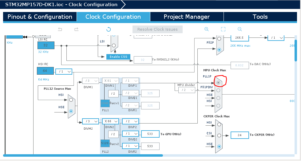

This one is made with default settings when I first created a empty project with STM32MP157D-DK1 board. Here the PLL1 lock is the clock of the MPU.

‎2024-08-11 12:22 PM - edited ‎2024-08-11 2:37 PM
Here is the solution: Go to the pin configuration tab in STM32CubeIDE. Then select RCC and change "User defined" from FALSE to TRUE. Then you are allowed to change the MPU clock. Make sure that the output is exactly 650 MHz. Just copy the STM32MP157D-DK1 clock configuration. Done!
By the way! When I re-generate the code, the U-boot .dts files gets reseted. All code within BEGIN and END disappears.
