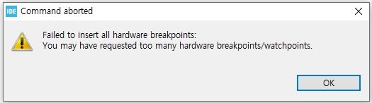

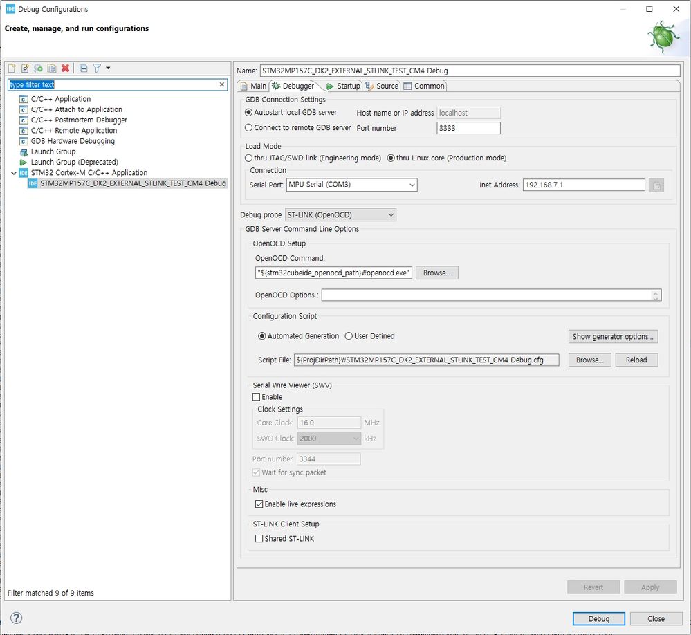

Debugging works by connecting cables to CN7 and CN11 in STM32MP157C-DK2 and setting them as shown in the attached figure.
However, if you connect ST-LINK v2/v3 to CN12 pin header of STM32MP157C-DK2 and set it as shown in the attached picture, debugging will not proceed and a command aborted message will be displayed as shown in the attached picture.
Debugging does not work even if the resistors of SB17, SB19, SB20, SB22 are removed from the board and the debugging settings are changed. I don't know what the problem is. I want to know how I can debug using ST-LINK.
