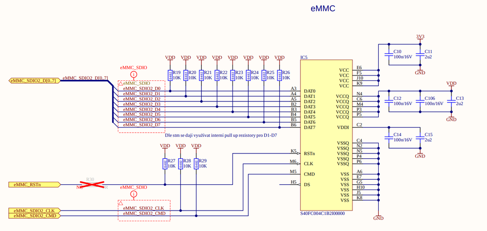

I am having difficulties with the MMC bus and the external SDIO wifi module. We are using the wifi module jody-w263 from U-blox with the OSD32MP1, and the communication with the module works, but it is quite slow. The wifi module is capable of SDR 104 and DDR50 communication speeds, but I add the support to the DTS, the communication is broken and the device returns the -110 while initializing.
How can I add support for higher speeds?
I attach the working dts, dmesg, ios and caps, and relevant schematic.

Bernard PUEL
We saw 2 issues in the DT:
EMMC:
vmmc-supply = <&v3v3>;
vqmmc-supply = <&vdd>;
mmc-ddr-3_3v;
vdd being at 1,8v, it is not consistant with the others property (at 3,3v).
We don't have the emmc schematics but if the emmc is at 3,3v, the IOs have to be also at 3,3v.
WLAN:
vqmmc-supply = <&v1v8_ldo1>;
mmc-pwrseq = <&wifi_pwrseq>;
Current declaration will force the driver to switch between 3,3v and 1,8v. But the IOs are statically supplied at 1,8v. So the driver has nothing to do. the "vqmmc-supply" property shall be removed from the DT.
Bernard PUEL
if EMMC IOs are at 1,8v, you will need to replace "mmc-ddr-3_3v" with "mmc-ddr-1_8v"
And
if the EMMC IOS are at 3,3v, you will need to replace "&vdd" with "&v3v3"

Bernard PUEL
I see vdd is 3,3v in your trace. Shouldn't it be 1,8v instead ?
Bernard PUEL
By the way, do you need further assistance or not ?

No, the main supply is 3v3 but the communication logic (signal voltage) uses the 1v8. I attach the schematic of the eMMC.

For Emmc:
With this configuration only (you said it fails), could we get the full log ?
 mmc-ddr-1_8v;
Bernard PUEL
Sorry again I did not read rightly. On EMMC all is ok.
Please try WLAN sdmmc3 like described above.
