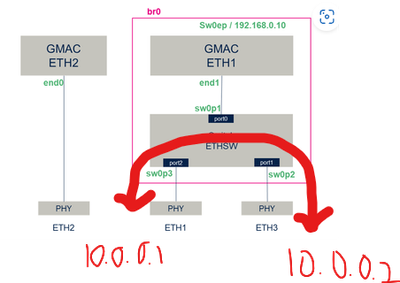

I have the STM32MP257x-EV1 up and running the base image. I have included the layers for the Ethernet switch and TSN. I am trying to understand the embedded Ethernet Switch better. I am working with the assumption that I can plug in two endpoints to ETH1 and ETH3 with no interaction from the MPU and pass ethernet traffic (e.g., ping).
But this does not work from the get-go. Is there something that needs to be done to enable it?

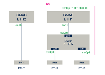

Hello, Here is the network config after you applied the linux expansion for tsnswch. There is no application so you have to do it manually. For ex, if you assign IP 192.168.0.20 on the PC plugged on ETH1, you will be able to ping sw0ep or ping another PC plugged on ETH3 with a static IP set to 192.168.0.30. If Then you want to test ETH2, you can assign end0 a static new network IP address and activate IPforwarding on the board.

The issue I am bringing up, is the fact that what you suggest is exactly what I tried, and it does not work.
I confirmed I have tsnswch image up and running, I get interfaces sw0p1,2,3 and end0/end1. I do not get a Sw0ep endpoint though (or br0), unsure if I need to configure that?
Lastly, the links for sw0p3 and sw0p2 go up and down accordingly when pulling cables, so the links are up, but no traffic will pass. I have the machines configured as 10.0.0.1/24 and 10.0.0.2/24, but they cannot ping each other.

I did this = https://github.com/STMicroelectronics/meta-st-stm32mp-tsn-swch/blob/mickledore/README.md
Then flash the resulting image on my EV1 board. Here is the network config result on my side:

So I guess if you change IP adresse of "sw0ep" to 10.0.0.x you will be able to ping it and ping the machines connected to the switch interface.

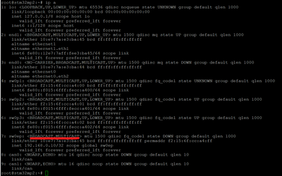

ip a results in no br0 and sw0ep being in the down state for me.
Here is what I am trying in the below picture that doesn't work.

It seems your default network configuration is wrong, so need to check why ....
As described in wiki the network config is set thanks to this script = /usr/sbin/ttt-ip-init-systemd.sh
So try to apply manually the config and check what is failling.
2024-09-18 12:08 AM
especially this sequence =
ip link add name br0 type bridge
ip link set dev br0 up
ip link set dev sw0p1 master br0 up
ip link set dev sw0p2 master br0 up
ip link set dev sw0p3 master br0 up
ip link set dev sw0ep up
