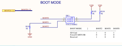

hi @PatrickF ,
Actually, my boot1 pin is connected to the ground, it is always present as 0 as like (stm32mp157f-dk2),
i am attaching the custom board of bootpin, connection
until you fix your PCB to have correct BOOT pins allowing to select the memory you implemented (there is no eMMC on STM32MP157x-DK board), you might have a solution using OTP3 primary_boot_source field to the value 3.

l done the changes into my custom board hardware and setup the boot pin( 0 1 0 ).
