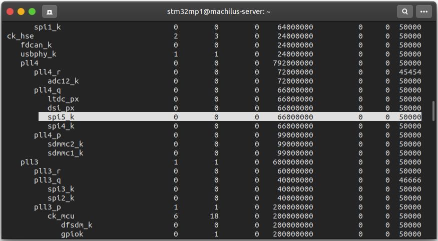

Hi PatrickF (ST Employee)
I modified DTS and Firware by referring to the advice.
I looked at it using the command "cat /sys/kernel/debug/clk/clk_summary" and spi5_k was assigned to "pll4_q".
But didn't solve the problem.
If you set "PCLK2", "HSI", "CSI" and "HSE" in the SPI5 clock mux, it operates normally.
However, only "PLL4Q" does not generate the clock as set.

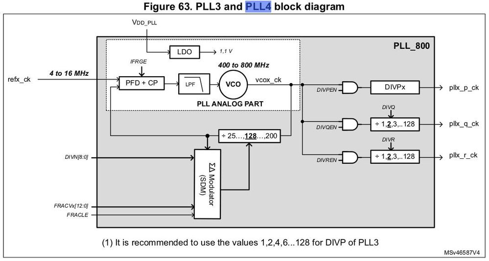

Regarding the linux side of your configuration, I've found your PLL4 freq out of spec. Did you use CubeMx to modify the clock tree? Also for the M4 configuration it would have been much safer to use this tool to prevent setup errors.
root@stm32mp1:~# cat /sys/kernel/debug/clk/clk_summary
    pll4                             2       2       0  792000000         0    0 50000
Using your setup, changing the TF-a clock settings on the DK2 board using the spi5 node with the CLK_SPI45_PLLQ
I found spi5_k  around 30MHz                  0       0       0   29700000         0    0 50000
Regards
Hi OlivierK (ST Employee)
I entered the same frequency settings into the STM32CubeMX as the shared DTS file, but there are no errors.
If I set "/6" in DIVM4, CubeMX will not throw an error if the condition of "400Mhz =< PLL4 <= 800Mhz" is met.
So setting "792Mhz" in PLL4 didn't cause any warnings or errors in CubeMX.
Is the STM32CubeMX wrong?, We can also share "ioc" files.
I used STM32CubeMX version 6.1.1

​Hi Machilus (Community Member),
For the PLL VCO specifications it is indeed correct, anyway if you've generated your project with CubeMX it should be error free. I did not see the .ioc in the files you've shared, so I was assuming you didn't use CubeMX.
0693W000007ERSDQA4.jpgIn the picture above, you can see that "spi5_k" is set to 66Mhz in "PLL4Q".
Since the clock setting of "PLL4" is as follows, it is normal that 66Mhz appears in "PLL4Q".
/* VCO = 792.0 MHz => P = 99, Q = 66, R = 72 */
pll4: st,pll@3 {
compatible = "st,stm32mp1-pll";
reg = <3>;
cfg = < 5 197 7 11 10 PQR(1,1,1) >;
However, if i set the Baudrate of SPI5 of M4 firmware to "LL_SPI_BAUDRATEPRESCALER_DIV2" in production mode booted with Linux, "SPI5_SCK" will output 2.6Mhz instead of 33Mhz.
