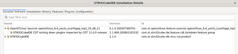

  • I checked in Help > About STM32CubeIDE > Installation Details and it seems that it is stuck to the old version (v25.06.11) it is my first suspect in here :

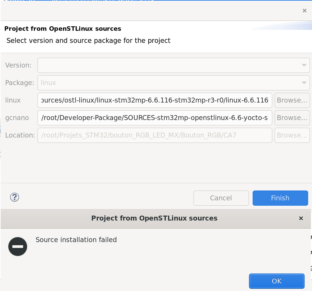

And there is the big problem I am fighting with for 3 days :
When I right-click on the A7 project > open an OpenSTLinux Project and fill the paths :
I can't manage to get the version loaded in the first field, as in the tutorial !
That's why I'm asking for help on these questions :
- Should the plugin version be 26_02_18 instead of 25_06_11 ?
- Does someone have an idea of why the version is not loaded and ultimately the "Source installation failed" ?
- Do I really need to update the Device Tree so that my MCU project works without bypassing the gpio driver's file ?
