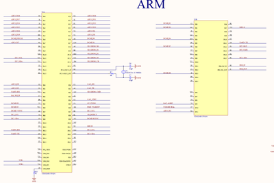

Hello teachers, I am a developer of the STM32MP157F chip and would like to ask you a question about device tree configuration. Please help me.
    The version I am currently using is as follows:
        optee 4.10
        uboot 2023.10
        linux 6.6
    At present, the system startup is stuck in the kernel stage. I have attached the device tree and system startup log. Can you help me analyze the specific reasons? Thank you very much.
      I've been stuck on this problem for many days。
