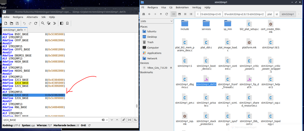

Do you think this number has to do with PZ4 and PZ5 pins? If I change this base address to another base address for the PF14 and PF15 pins. This might work? @PatrickF
