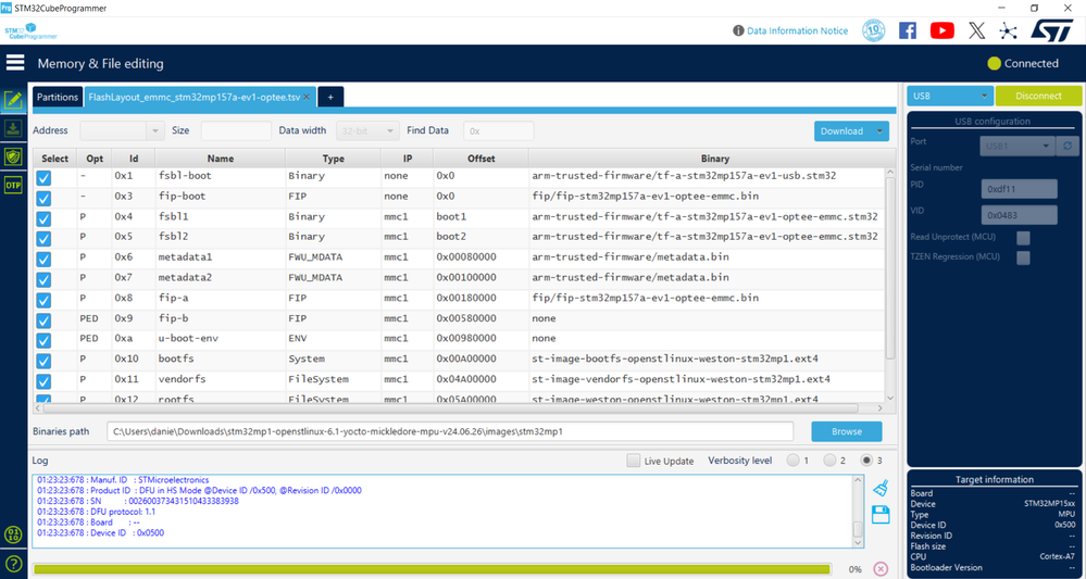

I have made my own STM32MP1 board with the STM32MP151AAC3 processor. Right now I'm faceing issues with the software STM32CubeProgrammer and I don't know why this happens.
My goal is to flash the eMMC via the UBS OTG. I have SDIO2 as eMMC by the way.
What we can see here is that:
  • The STM32CubeProgrammer regonize the STM32MP1 processor and its name
  • The USB OTG of the STM32MP1 processor is working
  • I'm using the OpenSTLinux for STM32MP157 processor because it's the only one that are avaiable as Starter Package . It's only a minor difference between STM32MP151, STM32MP153(CAN FD) and STM32MP157(CAN FD + DSI)
  • The flashing fails on 0x1 fsbl-boot

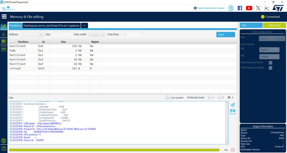

  • The STM32CubeProgrammer can recognize the partisions when I connect via USB OTG
So the question is simple:
Why does STM32CubeProgrammer get timeout?
The full log can be found here: https://pastebin.com/q9GttMiR

  00:57:47:117 : Start Embedded Flashing service
  00:57:47:151 : sending a set alternate setting request with index: 5
  00:57:47:152 : receiving packet
  00:57:47:153 : DFU status = 0 : OK
  00:57:47:153 : DFU state = 2  : dfuIDLE
  00:57:47:153 : UpLoading data
  00:57:47:153 : sending a set alternate setting request with index: 1
  00:57:47:154 : Memory Programming ...
  00:57:47:154 : Opening and parsing file: tf-a-stm32mp157a-ev1-usb.stm32
  00:57:47:197 :   File          : tf-a-stm32mp157a-ev1-usb.stm32
  00:57:47:197 :   Size          : 220.41 KB
  00:57:47:197 :   Partition ID  : 0x01
  00:57:47:197 : Download in Progress:
  00:57:47:198 :   Size          : 225702 Bytes
  00:57:47:199 : sending packet nbr: 0
  00:57:47:200 : DFU status = 0 : OK
  00:57:47:200 : DFU state = 2  : dfuIDLE
  00:57:47:201 : Status: 0, State: 2
  00:57:47:204 : DFU status = 0 : OK
  00:57:47:204 : DFU state = 4  : dfuDNBUSY
  00:57:49:178 : sending packet nbr: 152
  00:57:49:179 : DFU status = 0 : OK
  00:57:49:179 : DFU state = 5  : dfuDNLOAD-IDLE
  00:57:49:179 : bwPollTimeout = 1
  00:57:49:180 : Status: 0, State: 5
  00:57:49:183 : DFU status = 0 : OK
  00:57:49:183 : DFU state = 4  : dfuDNBUSY
  00:57:49:184 : bwPollTimeout = 1
  00:57:49:488 : DFU state = 4  : dfuDNBUSY
  00:57:49:488 : bwPollTimeout = 1
  00:57:49:492 : DFU status = 0 : OK
  00:57:49:492 : DFU state = 5  : dfuDNLOAD-IDLE
  00:57:49:492 : bwPollTimeout = 1
  00:57:49:495 : sending packet nbr: 162
  00:57:49:495 : DFU status = 0 : OK
  00:57:50:059 : DFU status = 0 : OK
  00:57:50:060 : DFU state = 5  : dfuDNLOAD-IDLE
  00:57:50:060 : bwPollTimeout = 1
  00:57:50:061 : Status: 0, State: 5
  00:57:50:090 : DFU status = 0 : OK
  00:57:50:090 : DFU state = 4  : dfuDNBUSY
  00:57:50:090 : bwPollTimeout = 1
  00:57:50:094 : DFU status = 0 : OK
  00:57:50:095 : DFU state = 5  : dfuDNLOAD-IDLE
  00:57:50:095 : bwPollTimeout = 1
  00:57:50:099 : Segment[0] downloaded successfully
  00:57:50:099 : File download complete
  00:57:50:099 : Time elapsed during download operation: 00:00:02.454
  00:57:50:099 : RUNNING Program ...
  00:57:50:099 :   PartID:      :0x01
  00:57:50:099 : DFU status = 0 : OK
  00:57:50:099 : DFU state = 5  : dfuDNLOAD-IDLE
  00:57:50:099 : bwPollTimeout = 1
  00:57:50:101 : sending a dfu end of download request
  00:57:50:102 : DFU status = 0 : OK
  00:57:50:102 : DFU state = 7  : dfuMANIFEST
  00:57:50:102 : bwPollTimeout = 1
  00:58:22:076 : DFU status = 0 : OK
  00:58:22:345 : DFU state = 2  : dfuIDLE
  00:58:24:127 : sending a set alternate setting request with index: 5
  00:58:29:426 : receiving packet
  00:58:59:455 : libusb get status error [-7] : LIBUSB_ERROR_TIMEOUT
  00:58:59:455 : sending a clear status request
  00:59:59:496 : libusb get status error [-7] : LIBUSB_ERROR_TIMEOUT
  00:59:59:496 : an error occured after sending the clear status request
  00:59:59:496 : Status: errUNKNOWN, State: dfuERROR
  00:59:59:551 : sending a clear status request
  01:00:59:498 : libusb get status error [-7] : LIBUSB_ERROR_TIMEOUT
  01:00:59:498 : an error occured after sending the clear status request
  01:00:59:498 : Status: errUNKNOWN, State: dfuERROR
  01:00:59:498 : sending a clear status request
  01:01:59:500 : libusb get status error [-7] : LIBUSB_ERROR_TIMEOUT
  01:01:59:500 : an error occured after sending the clear status request
  01:01:59:500 : Status: errUNKNOWN, State: dfuERROR
  01:01:59:500 : sending a clear status request
  01:03:05:691 : libusb get status error [-7] : LIBUSB_ERROR_TIMEOUT
  01:03:05:827 : an error occured after sending the clear status request
  01:03:05:828 : Status: errUNKNOWN, State: dfuERROR
  01:03:05:829 : sending a clear status request
  01:03:59:506 : libusb get status error [-7] : LIBUSB_ERROR_TIMEOUT
  01:03:59:507 : an error occured after sending the clear status request
  01:03:59:507 : Status: errUNKNOWN, State: dfuERROR
  01:04:00:400 : sending a clear status request
  01:04:59:544 : libusb get status error [-7] : LIBUSB_ERROR_TIMEOUT
  01:04:59:544 : an error occured after sending the clear status request
  01:04:59:544 : Status: errUNKNOWN, State: dfuERROR
  01:04:59:544 : sending a clear status request
  01:05:59:546 : libusb get status error [-7] : LIBUSB_ERROR_TIMEOUT
  01:05:59:546 : an error occured after sending the clear status request
  01:05:59:546 : Status: errUNKNOWN, State: dfuERROR
  01:05:59:546 : sending a clear status request
  01:06:59:550 : libusb get status error [-7] : LIBUSB_ERROR_TIMEOUT
  01:06:59:550 : an error occured after sending the clear status request
  01:06:59:550 : Status: errUNKNOWN, State: dfuERROR
  01:06:59:550 : sending a clear status request
  01:07:59:555 : libusb get status error [-7] : LIBUSB_ERROR_TIMEOUT
  01:07:59:555 : an error occured after sending the clear status request
  01:07:59:556 : Status: errUNKNOWN, State: dfuERROR
  01:07:59:556 : sending a clear status request
  01:08:59:556 : libusb get status error [-7] : LIBUSB_ERROR_TIMEOUT
  01:08:59:556 : an error occured after sending the clear status request
  01:08:59:557 : Status: errUNKNOWN, State: dfuERROR
  01:08:59:742 : unable to switch the device to dfuIDLE state
  01:08:59:857 : Error: an error occured while uploading data from the virtual partition 0xF1
  01:09:03:186 : Error: Start operation failed at partition 0x01
  01:09:06:454 : Error: TSV flashing service failed
  01:09:39:537 : Disconnected from device.
