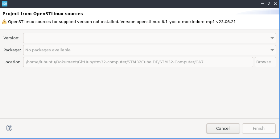

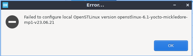

Anyway. I have to show a bug. I cannot build an OpenSTLinux Project inside STM32CubeIDE.

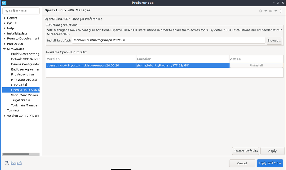

I first created a project for my STM32MP1 processor, then I tried to attach the SDK with the STM32CubeIDE. But it did not work well.
I have STM32CubeIDE 1.16.0 and Lubuntu 22.04 and the latest SDK.
So what I'm looking for, is some way to compile the kernel, TF-A, Optee and U-boot with STM32CubeIDE. If it's possible. Or else....it's impossible to follow the wiki of STM32MP.

I found the solution. It was an issue when you're importing a project and migrate it to the latest version. Then you're about to facing these kind of issues.
So the solution was: Create a new project and copy the parameters from the .ioc file to the new one.
But...it's still a bug inside the STM32CubeIDE.
