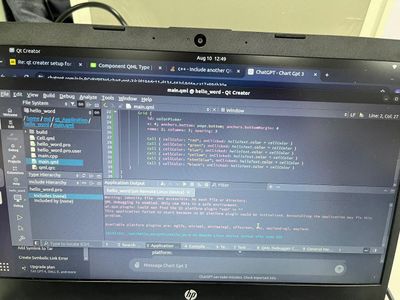

how to setup qt creater application for STM32MP157f-Dk2 board , and where is the location of the toolchain location and how to setup qt version .

qt version(qmake) done from SDK pathqt version(qmake) done from SDK pathgcc done from SDK pathgcc done from SDK pathg++ done from SDK pathg++ done from SDK pathdebugger done from SDK pathdebugger done from SDK pathCMake done from SDK pathCMake done from SDK path           please help me out from image 6 why this happenbut this error comes why ?but this error comes why ?

very good, your environment looks ready to develop your application.
I suggest anyway you run an existing "hello world" example before doing your own one.
Please look at Qt documentation, like this one: https://doc.qt.io/qt-5/qml-tutorial1.html
And let me know if compilation and execution is fine.

please help me out this, it is showing warning.
and i run the hello world application(Hello_World) without sudo  it is working but , when i use the application with sudo  it will give the error  as like a warning.
please go to following chapter for more details
"9.6. Configure the STM3 MPU Kit" in
https://wiki.st.com/stm32mpu/wiki/X-LINUX-QT_Expansion_Package
To summarize: the 2 variables below must be set in Qt Creator "Run" Qt configuration when you launch test from the host:
XDG_RUNTIME_DIR=/run/user/1000
QT_QPA_PLATFORM=wayland
 When you execute the test from the target, these variables are already set by default.
