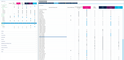

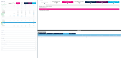

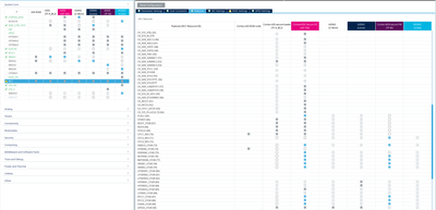

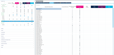

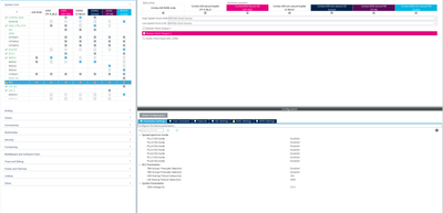

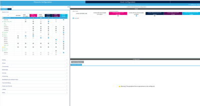

I believe there's something wrong with RIF configuration, but I have no clue what. The story behind this is that I created CubeMX project selecting STM32MP257F-EV1 board and initialized all peripherals to their defaults, and started moving and removing unneeded peripherals one by one (my custom board is very similar to EV1, hence the decision to select EV1 board as starting point).
When I click Generate Code in CubeMX for this project I do get RCC warning:
Here are all the RCC settings:
Is it even possible to only run A35 without M33 at all?

How do I disable M33 core in CubeMX project? I'm trying to untick it but the tickmark keeps going back to "Avtivated". Also I can not remove it from OP-TEE and Linux contexts, it says this peripheral is forced. When I started the project I used board selector to select EV1 board.
I did have a look into IAC and SERC errors on your wiki, I could not figure out what's going on. As I mentioned my IAC exception ID is 156 which corresponds to RCC block, and SERC exception ID is 35 which corresponds to UART5 which I removed from M33 context and added to Linux for my own needs.
