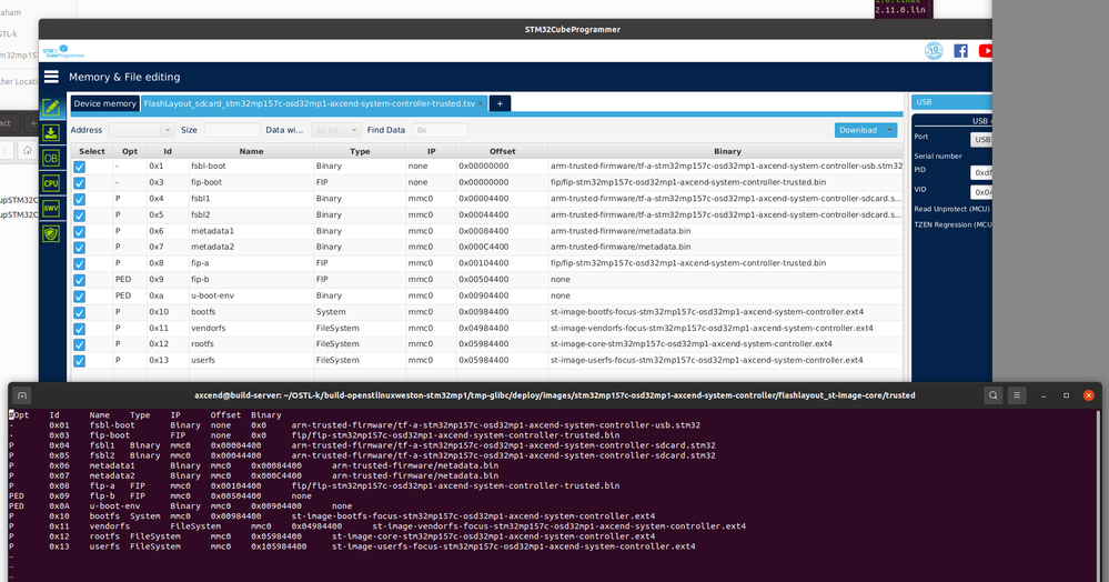

There seems to be an issue with CubeProgrammer and parsing hex strings that are longer than 8 characters. For example, an offset of 0x05984400 will parse correctly but 0x105984400 will not. It will incorrectly parse as 0x05984400. I am trying to reference an offset that is past the 4GB mark so CubeProgrammer is truncating my offset value. Is it supposed to do that? What is the best way to reference partitions past the 2^32 bits mark? Are other people able to get it to work or am I just doing something weird?
Edit: Also the images in Kirkstone are defaut to a rootfs size of 4GiB.

I want to partition a 8GB eMMC and 8GB SDMMC. These are the numbers I am getting from my default build of Kirkstone on st-image-core. I need the bit in the 32nd place to be available (0-31 works fine) because I am doing a dual rootfs setup and am splitting the rootfs in to 3GB parts each. So I need to place a partition at around 0x165A0BC00 which CubeProgrammer is going to truncate to 0x65A0BC00 so it is going to the wrong place. If you guys do a test and put in a number for the flash layout offset on 2.12 CubeProgrammer that is greater than 0xFFFFFFFF will it get truncated as well?
Also I forgot to mention, I am using a stm32mp157c

Hammy
Hi @Bernard PUEL​ ,
Thanks for looking at this! Much appreciated. Yes, the Yocto TSV is correct. The file generated by my Yocto is correct as well. My issue is that when I load that file into cube programmer that it doesn't read in the offset values correctly. I attached a picture for reference. Notice that the last value for the userfs and what cube programmer reads is different.0693W00000Y9W3kQAF.png

Bernard PUEL
We could reproduce the issue and the flashing is ok (with the right offset from the tsv file).
So the issue is only a UI effect and an internal ticket was submitted to solve it.

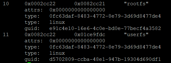

Bernard PUEL
Hello Hammy,
Sorry we only tested with latest releases (V2.12 Cube Prog) on Windows:
0693W00000Y9nnuQAB.png0693W00000Y9nnpQAB.pngSo you can see the UI has wrong display but the userfs partition is well flashed on the board.
