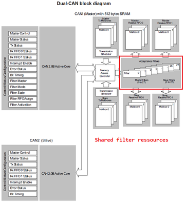

1. DUAL bxCAN in STM32 MCUs
Most of the STM32 MCUs feature a CAN interface. Some of them have one CAN instance like the STM32F103 MCU, others have two CAN instances like the STM32F429 MCU and others have 3 CAN instances like the STM32F769 MCU.
To optimize the internal architecture of the STM32, when two CAN instances are available, they share the same RAM (512 bytes), and filters. In that case, a mechanism to manage the resources is needed to handle this sharing mainly the filters resources. From an internal architecture standpoint, CAN1 is a master while CAN2 is a slave of CAN1. So, to use CAN2, CAN1 RCC clock shall be enabled.
The figure above (from RM0090 but does also appear in other reference manuals) illustrates the block diagram in a Dual-CAN implementation.
As shown in the figure the filters are shared between CAN1 and CAN2. The number of filters shared between the two instances is 28. When the two CAN instances are used at the same time in the application, the user can assign more filter resources to CAN1 than CAN2 and vice versa. The user can even assign all the filter resources to one instance. In that case the second instance is unusable. For this, the CAN2 Start Bank bits (CAN2SB[5:0]) in the CAN_FMR register are important to take in consideration to manage the shared filter resources. Note that in TRIPLE-bxCAN configuration, CAN3 is independent from CAN1 and CAN2. In this case, CAN3 is a master, and it has its own resources.

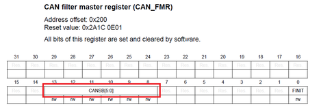

In the STM32Cube HAL, the member SlaveStartFilterBank of the CAN_FilterTypeDef structure, is the value that corresponds to CAN2SB to be set in the CAN_FMR register.

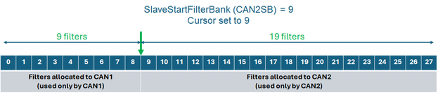

The value of CAN2SB can be seen as "a cursor" moving to the left or to the right to configure the number of filters allocated to CAN1 and CAN2. If the cursor is moved to the left more filters are allocated to CAN2. Conversely, if the cursor is moved to the right more filters are allocated to CAN2.

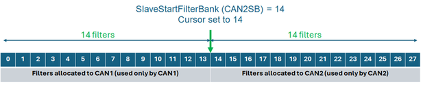

If SlaveStartFilterBank = 14: 14 filters are allocated to CAN1 (filter 0 to 13) and 14 filters are allocated to CAN2 (filter 14 to 27).

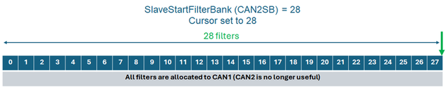

If SlaveStartFilterBank = 28: all filters are allocated to CAN1. In that case CAN2 are not used.

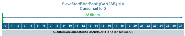

If SlaveStartFilterBank = 0: all filters are allocated to CAN2. In that case CAN1 is not usable, but CAN1 APB clock should be enabled since it is a master as mentioned previously.

Case 1 - filter resources are shared equally between CAN1 and CAN2 (configuration after reset):
Case 2 - more filter resources are allocated to CAN2:
Case 3 - all the 28 filters are allocated to CAN2. CAN1 is no longer useful:
Case 4: All the 28 filters are allocated to CAN1. CAN2 is no longer useful:

you write that if we want to assign all filters to CAN1, we need to set CANSB to 28. However, in RM0390, in section 30.9.4 CAN filter registers → CAN filter master register (CAN_FMR), the description of the CANSB bits states that:
  • to assign all filters to one CAN set CANSB value to zero and deactivate the non
    used CAN
  • to use CAN1 only: stop the clock on CAN2 and/or set the CAN_MCR.INRQ on
    CAN2
  • to use CAN2 only: set the CAN_MCR.INRQ on CAN1 or deactivate the interupt
    register CAN_IER on CAN1
So where is the correct information?

You mentioned that CANSB should be set to 28 if only CAN1 is used and all filters are assigned to it.
If that is true, then the CANSB description in the bxCAN section of the RMs should be changed, shouldn’t it?
