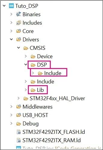

Here are the steps to follow to copy the DSP drivers into the project:
Support DSP in the project workspace
In the generated project, create a folder under ..\Drivers\CMSIS named DSP.
Copy <STM32Cube_Repository>\STM32Cube_FW_F4_V.X.XX.X\Drivers\CMSIS\DSP\Include and paste in in the created folder
Copy <STM32Cube_Repository>\STM32Cube_FW_F4_V.X.XX.X\Drivers\CMSIS\Lib and paste it under ..\Drivers\CMSIS.
After being copied and refreshing the project, the added folders appear automatically in the STM32CubeIDE workspace:

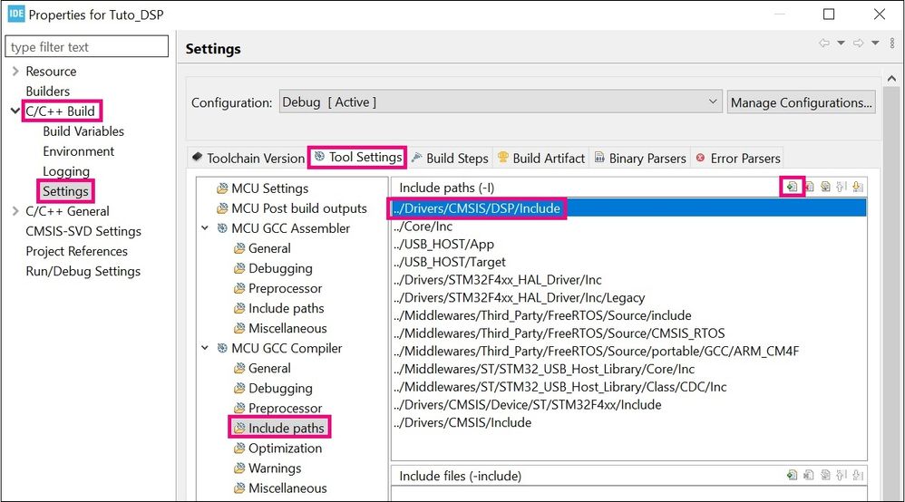

ii. Include paths
The purpose of this part is to describe the steps to follow in order to support new header files:
Select the project from the Project Explorer section
From Project menu or File menu, go to Project properties > C/C++ Build >
Settings > Tool Settings > MCU GCC Compiler > Include paths.
Click on “Add” to include the new paths.
Add ../Drivers/CMSIS/DSP/Include path

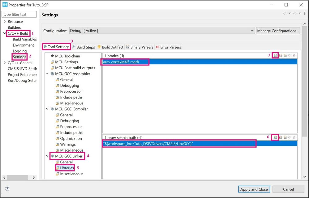

iii. Update libraries
The purpose of this part is to describe how to update the libraries in the project.
The first step is to add the libraries' path in the project settings:
Select the project from the Project Explorer section, then from Project menu or File menu, go to Properties > C/C++ Build > Settings > Tool Settings > MCU CGC Linker > Libraries > Library search Path > Add.
Select the GCC library present in the workspace path: ../Drivers/CMSIS/Lib/GCC.
Now, to add the specific library to work with, select the project from the Project Explorer section.
From Project menu or File menu, go to Properties > C/C++ Build > Settings > Tool Settings > MCU CGC Linker > Libraries > Libraries (-l) > Add and insert the following library: "arm_cortexM4lf_math".
Warning:
Make sure that you are using the “/” and not the “\” in the paths.
Do not use “:libarmcortexM4lf_math.a”. This usage is not recommended as it can lead to side-effects in some use cases.
- Use "arm_cortexM4l_math" with STM32WL series.

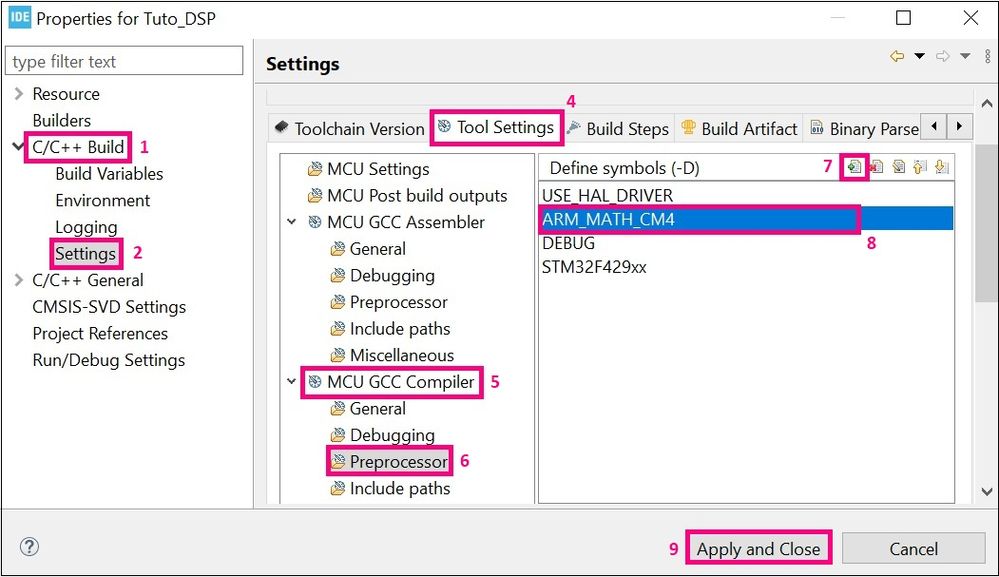

The final step, is to add the “ARM_MATH_CM4” symbol to the project, as presented in the photo below:
Note: |
