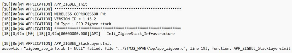

Hi, I have a small problem with the zigbee strack i hope someone could give me an direction for.
When I boot up I get an error just after it initialized the CPU2(M0).
static void APP_ZIGBEE_StackLayersInit(void)
APP_DBG("APP_ZIGBEE_StackLayersInit");
zigbee_app_info.zb = ZbInit(0U, NULL, NULL); <<<--- seems to return 0,0,0,0
However IPCC seems to work since it communicates the version nr etc.0693W00000Nrz2zQAB.png

Remy ISSALYS
Can you give more information about which application are you using and which version ?
Best Regards

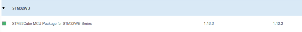

KJeps.3
I have tried first to make my own project, but afterwards I took an example and changed the mcu to 30CE...
KJeps.3
Remy ISSALYS
Please check if you have taken the stack from this directory to run it on STM32WB3x.
Best Regards
I think I have taken it from this path:
C:\Users\xxxxxx\STM32Cube\Repository\STM32Cube_FW_WB_V1.13.3\Projects\STM32WB_Copro_Wireless_Binaries\STM32WB3x
Same version as the package in cubeIDE...
I know see the one in the link is 1.4.0...
Do I then need to update the project also?
You can still use your application with the stack v1.14.0.
