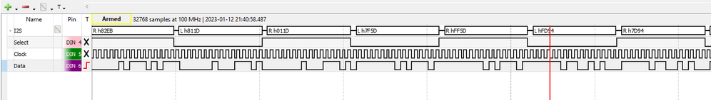

I do not have a scope, but I do have a logic analyzer. I am not sure how to interpret what I see on the bus and cannot trigger and log enough samples to get the whole sequence.
Thank you.
eeprom
Here are some logic analyzer captures that highlights a clear behaviour change.
Notice that the Left and Right channels are getting the same value when I am letting the sai device roll on dma and just setting the buffer to 0 to stop playing (sound is being played during the capture):

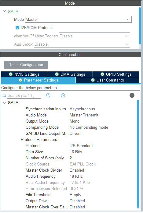

And when I am simply adding the HAL_SAI_DMAStop function call, things get weird, there seems to be some mismatch between right and left channel values (I am using I2S in mono mode):
0693W00000Y88u4QAB.pngHere is my SAI device configuration:
