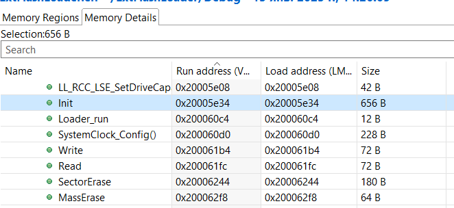

Thank you for the response.
As said, all methods used to interact with memory have already been checked. Moreover, the main project for this MCU uses the same drivers (for GPIO, SPI and W25Q32) without any issues.
Debugging the code with Exteral Loader (in CudeIDE) works fine and all operations (Read, Write, SectorErase, MassErase) are working properly as well.
CubeProgrammer 2.0.4 could work with it successfully, but newer versions have the log output like this:

  14:55:18:007 : Error: Data read failed
Looks like it reaches the Init function, but fails to execute it. Same thing happens even if this function just configures clocks and returns "1" informing for successful execution.
