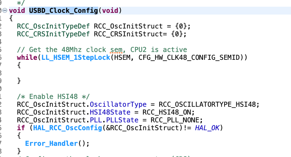

I'm developing an application which uses both USB CDC and BLE, using an stm32wb55cg USB_Dongle as my current target board. I've started by building two separate applications using STM32CubeMX(STM32Cube_FW_WB_V1.12.0) and stm32wb5x_BLE_Stack_full_fw1.12.0:
1.CDC be used for the application communicating with PC
2.A BLE P2P client
Both of these work fine on their own. But if I build an application that includes both components, the USB cdc device will not enumerate properly.
  • I've tried some solutions, but they haven't worked, such as :
  1. /**
    1. * This prevents the CPU2 to disable the HSI48 oscillator when
    2. * it does not use anymore the RNG IP
    3. */
    4.
    5. LL_HSEM_1StepLock( HSEM, 5 );
I also found that if I commented out  UTIL_SEQ_Run(UTIL_SEQ_DEFAULT); , USB worked fine, and vice versa.
  • The solution of this problem is very important to me, please help me!!!!!

You should poll Sem5 until granted before configuring the clock for USB. See AN5289, figure 9. Else M0 will switch it off.
This was the answer! Thanks!
