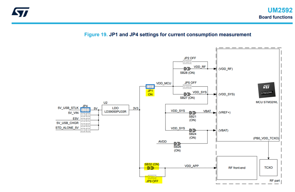

Where to connect the arm ULINK plus on the board for power measurement?
MStew.1

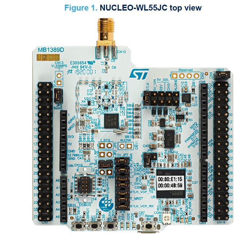

Hi, I am not so sure about where to connect the jumpers from the ULINK plus on my STM32WL55JC board to measure power consumption? Can anyone please help? The picture of the board is from the UM2592 User Manual. I couldnt find the information.
Thanks!
1 REPLY 1
Measure current through JP1, or through JP9 (with SB32 removed), depending on what you want.
