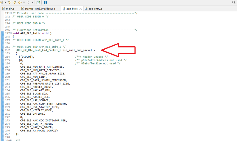

Hello.
I have my custom PCB with STM32WB55CEU. This board is tested so I m able to connect and sending data beetween "my PCB" and Smartphone.
Now I have new goal. The goal is to start scan process for nearby devices. I would like to hit breakpoint which is illustrated by the red arrow in the photo below.

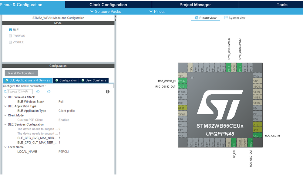

So I created new project, configure as Client profile with all default values. Is this configuration sufficient for the system to fulfill its purpose or should I add extra code to this project?
5 replies
Andrew Neil
December 19, 2024
That point is just a variable definition - so there's (probably) no executable code there on which to set a break point.

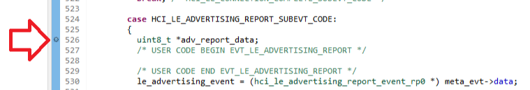

December 19, 2024
I added NOP(). I would like to hit the breakpoint.
As I understand this breakpoint will be reached when the STM32WB55 finds at least one device in its vicinity.
In next step I will be doing further operations.

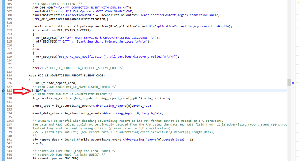

December 19, 2024
Program never reach this point:
