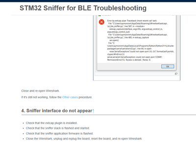

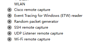

I ran into the same problem that the hardware platform is NUCLEO-WB55RG.I followed the https://wiki.stmicroelectronics.cn/stm32mcu/wiki/Connectivity:STM32_Sniffer_for_BLE_Setup_guide#Programming_the_board wiki step by step.The wireshark version is 4.4.2, based on windows11.
Sniffer interface do not appear.
I saw a solution to this problem in the wiki and tried again, but the problem still existed.
How do I know that the sniffer  protocol stack is started properly? There is no corresponding file/wiki to explain what happens when the sniffer firmware starts.
