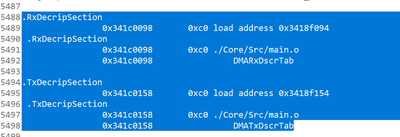

And before writing those lines in the linker script, I also got an address in this register which was 0x341c0098 (most certainly generated by STM32CUBEMX). I also found .RxDecripSection in RMII_PTP.v0_FSBL.map and the address was 0x341c0098.
under Debug/RMIIv0_FSBL.map
under Debug/RMIIv0_FSBL.list

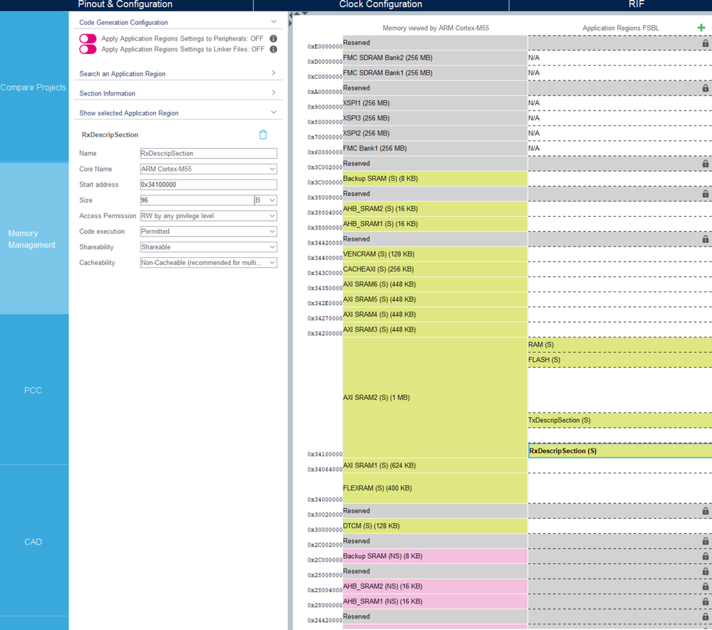

And the first Descriptor Address should be between 0x34064000 and 0x341FFFFF according to STM32CUBEMX.
But in the reference manual AXISRAM2 beginns at 0x34100000.
Also there is in STM32CUBEMX no possibility to configure the start address of the Rx Buffer.

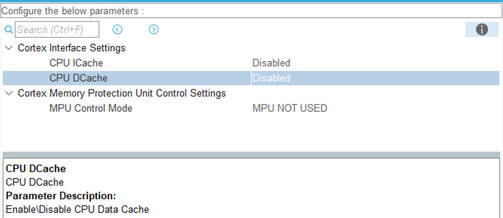

 And as I said I didn't enable MPU, or any caches:

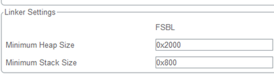

Maybe the Heap Size is to short  (I choose a bit more than 4*Rx Buffer Size)?
What would you suggest in this regard?

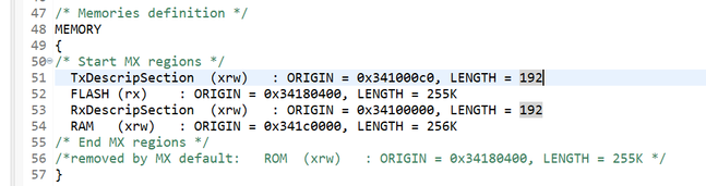

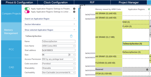

I have made some corrections concerning the attribution of the address for the descriptors, now I can see them in my linker script
(.RxDescripSection and .TxDescripSection are also defined under SECTIONS)
Nevertheless it came to another issue, I had to double the length of both descriptor, from 96 to 192. I don't understand why the size isn't enough. The size of a section is 96 and the descriptor length is 4.
That are the default values actually. When I set the size to 192 in STM32CUBEMX in the Memory Management it changes te descriptor length to 8.
