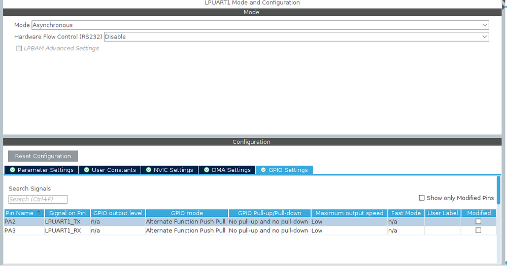

I have STM32WLE5CBU6 and I communicate with my Quectel chip over standard UART communication (interface LPUART, PA2, PA3) via AT commands.
Transmitting from STM to Quectel is always working well, but when I want to read response from Quectel chip, it in most cases does not work. Strange thing is that it sometimes after startup works (< 1 % of cases), however I do not have an idea why it sometimes works and sometimes does not.

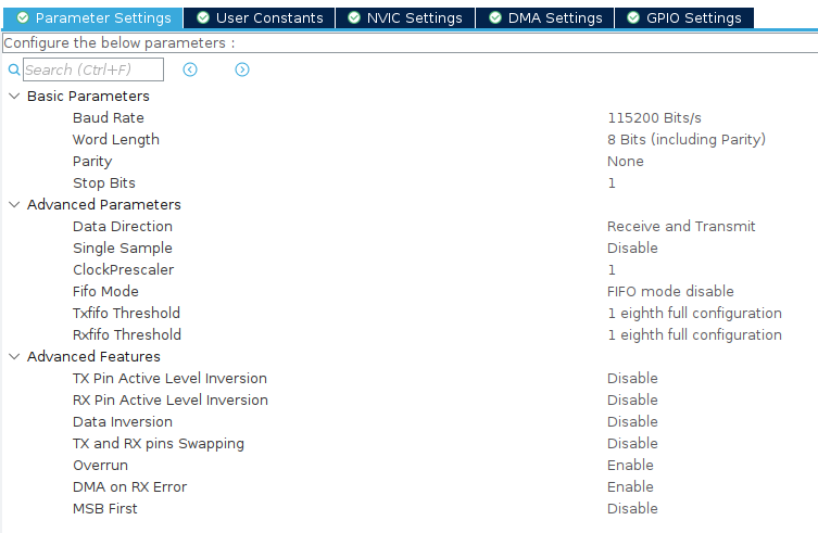

This is my setup of hlpuart1:
hlpuart1.Instance = LPUART1;
hlpuart1.Init.BaudRate = 115200;
hlpuart1.Init.WordLength = UART_WORDLENGTH_8B;
hlpuart1.Init.StopBits = UART_STOPBITS_1;
hlpuart1.Init.Parity = UART_PARITY_NONE;
hlpuart1.Init.Mode = UART_MODE_TX_RX;
hlpuart1.Init.HwFlowCtl = UART_HWCONTROL_NONE;
hlpuart1.Init.OneBitSampling = UART_ONE_BIT_SAMPLE_DISABLE;
hlpuart1.Init.ClockPrescaler = UART_PRESCALER_DIV1;
hlpuart1.AdvancedInit.AdvFeatureInit = UART_ADVFEATURE_NO_INIT;
hlpuart1.FifoMode = UART_FIFOMODE_DISABLE;
if (HAL_UART_Init(&hlpuart1) != HAL_OK) {Error_Handler();}
if (HAL_UARTEx_SetTxFifoThreshold(&hlpuart1, UART_TXFIFO_THRESHOLD_1_8) != HAL_OK) {Error_Handler();}
if (HAL_UARTEx_SetRxFifoThreshold(&hlpuart1, UART_RXFIFO_THRESHOLD_1_8) != HAL_OK){Error_Handler();}
if (HAL_UARTEx_DisableFifoMode(&hlpuart1) != HAL_OK) {Error_Handler();}
In CubeMX:
- NVIC interrupt is checked

Do you handle​ UART errors, mainly overflows?

Thanks for answer! No I do not, please, how can I do that?
