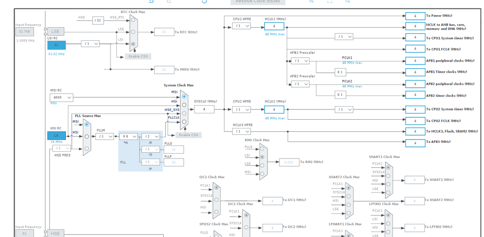

CLK config:

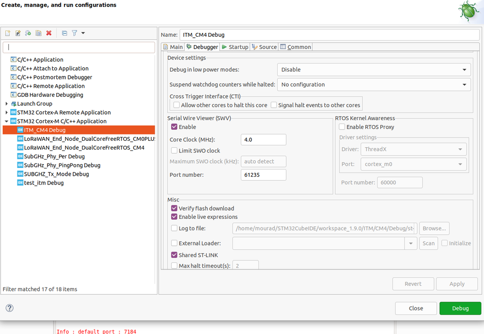

debug config:

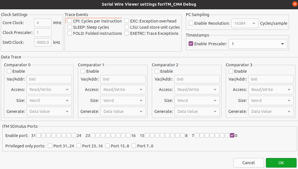

SWV settings:
and i click on the red button after that

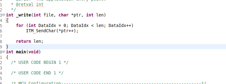

CODE:
override write function:
and then printf in main function
And ITM_sendchar(*ptr) is being executed, but no printf ouput in console.

‎2022-07-21 1:19 AM
Solved:
I have soldered the wrong bridge (SB6 instead of SB8) that means SWO not connected to STlink
