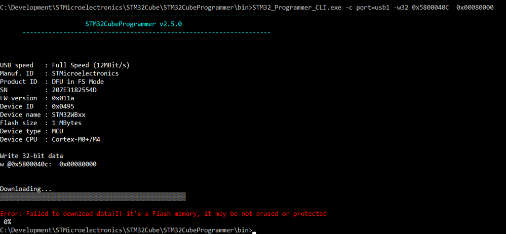

​As FUS version is V1.1.0, the revertion to the manufactory state can be achieved writing 0x00080000 at address 0x5800040C.
This is a PWR_CR4 ?
And write result is Error
0693W000003QZ1XQAW.png Mey be need to write 0x00008000 (set C2BOOT) ? not 0x00080000.

​Indeed!!! the value must be 0x00008000.
