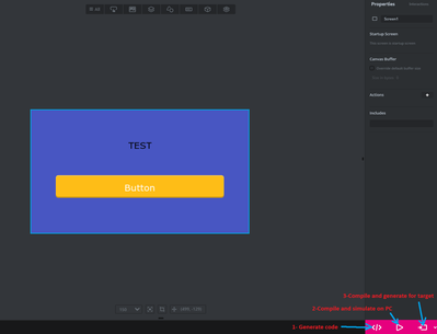

I don't have your project so I couldn't tell what problem you have.
I've attached a TouchGFX project running on STM32H745I-DISCO board.
You can use the TouchGFX Designer tool to directly generate code, compile, simulate and upload the application.
As shown in the below screenshot:
2- (Optional step) to compile and simulate the graphics on PC: mALLEm_3-1778057985557.png
3- To Compile and upload your TouchGFX application to the target (The DISCO board in your case): mALLEm_4-1778058047536.png

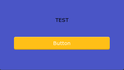

With the attached project, please test it by following step 1 and step 3. You should see this screen in the LCD:
