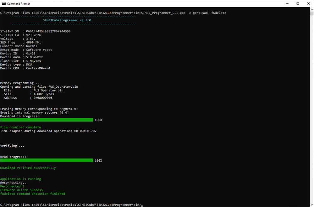

Had luck using CLI with SWD + the NRST pin hooked up. Does the stack fwdelete & fwupgrade without any issues now. Option PCROP.RDP byte is set to 1.

I can't replicate this at this very moment, but remember from last week having similar misbehaving deletes and upgrades when using port=usb1. It kept resetting and trying again populating an error nearly back to back after each retries. I've since switched to port=swd and also have the NRST pin attached and now both the fwdelete & fwupgrade works perfectly fine. Note that I've set PCROP.RDP byte to 1.
Please give this identical set-up a go and see if this works fine for you too. If it doesn't then may I suggest you look at your hardware between CubeProgrammer and the chip (cable, pc/laptop usb port, and/or drivers).
ps. confirmed working with STM32CubeProgrammer API v2.3.0. I might give 2.5 a try the next time I need to flash those bad boyz. Thanks for the heads up @Remi QUINTIN​

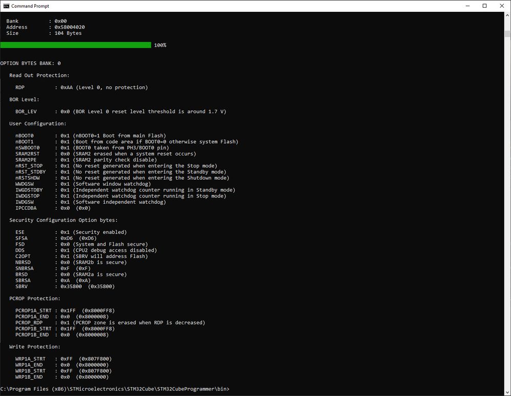

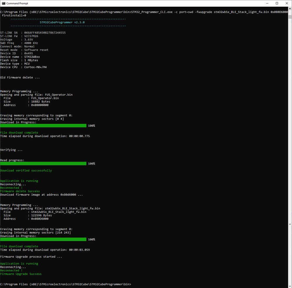

Done. Loaded stm32wb5x_BLE_Stack_light_fw.bin (en.stm32cubewb_v1-8-0.zip) with the set-up I'm using and all went fine. See traces and -op below, compare to what you have and have a go at it again. Good luck
  • STM32WB55CG (48qfn) custom board
  • FUS version is V1.1.0 (used: stm32wb5x_FUS_fw.bin from V.1.8.0 / en.stm32cubewb_v1-8-0.zip)
  • Using ST-Link 2.1 programmer (3V3, SWCLK, SWDIO, NRST, GND)
  • STM32CubeProgrammer API v2.3.0
STM32_Programmer_CLI.exe -c port=swd -fwdelete
STM32_Programmer_CLI.exe -c port=swd -fwupgrade stm32wb5x_BLE_Stack_light_fw.bin 0x080D6000 firstinstall=0
STM32_Programmer_CLI.exe -c port=swd -ob displ
