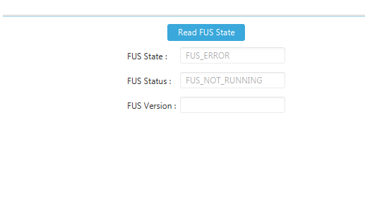

Using STM32CubeProgrammer I load last stm32wb5x_BLE_Stack_light_fw.bin, but when after that I try to run command -fwdelete, I get an error : "FUS_NOT_RUNNING".
I attach log file becose Idont understand whot is this.
But me application work fine and I see that stack is a last version.
Please help whot may bee .
I send call:
STM32_Programmer_CLI.exe -c port=usb1 -fwdelete -vb 3

Remi QUINTIN
Indeed!
Can you download all the option bytes?
Are you able to read the FUS either in CLI or GUI mode (possible only via the USB port).
In last resort we could activate the safe boot which will reset the chip in its manufactory state.
But I would like first to get the option bytes to better understand the possible cause of this blocking situation.
Can you download all the option bytes? - to chip or from chip?
Are you able to read the FUS either in CLI or GUI mode (possible only via the USB port) - how to read FUS ?
Remi QUINTIN
​From the chip. Use the CubeProgrammer tool in GUI mode . You can also use the CLI mode.
On the last picture I attached to this thread, you can see a button "read FUS state". It works well when the USB port is used.
Remi QUINTIN
​cli.exe -c port=usb1 -ob displ ... is the command to extract all options bytes
Reading FUS state:
and tis is a log for reading state:

19:48:06:385 : FUS state is FUS_ERROR
19:48:06:386 : FUS status is FUS_NOT_RUNNING
19:48:06:386 : Reconnecting...
19:48:06:416 : Reconnected
19:48:06:417 : Reconnected !
19:48:06:417 : Read FUS state command execution finished

Remi QUINTIN
Regarding the reading of the FUS state, the values are relevant when the FUS is active. One way to activate the FUS is to launch a command to the FUS, fwdelete for example. Th​en read the FUS state and version.
Regarding the option bytes, the RF stack seems to be correctly installed but the ESE = 0 means that the security is not enabled on this chip. I cannot clearly rely your issue to this configuration, but it is not a tested configuration at ST.
I would recommend getting rid of this chip and develop your application on a secure part (ESE = 1).
